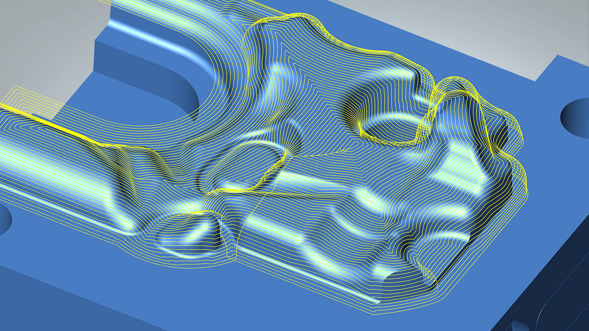

Finishing
Numerous strategies are available for finish machining and generating perfect surface finishes: This ranges from Profile Finishing to Equidistant Finishing.
Profile Finishing allows collision-free milling on all faces close to the contour and across the entire face formation.
Equidistant Finishing applies a uniform face infeed, even for steep faces.
