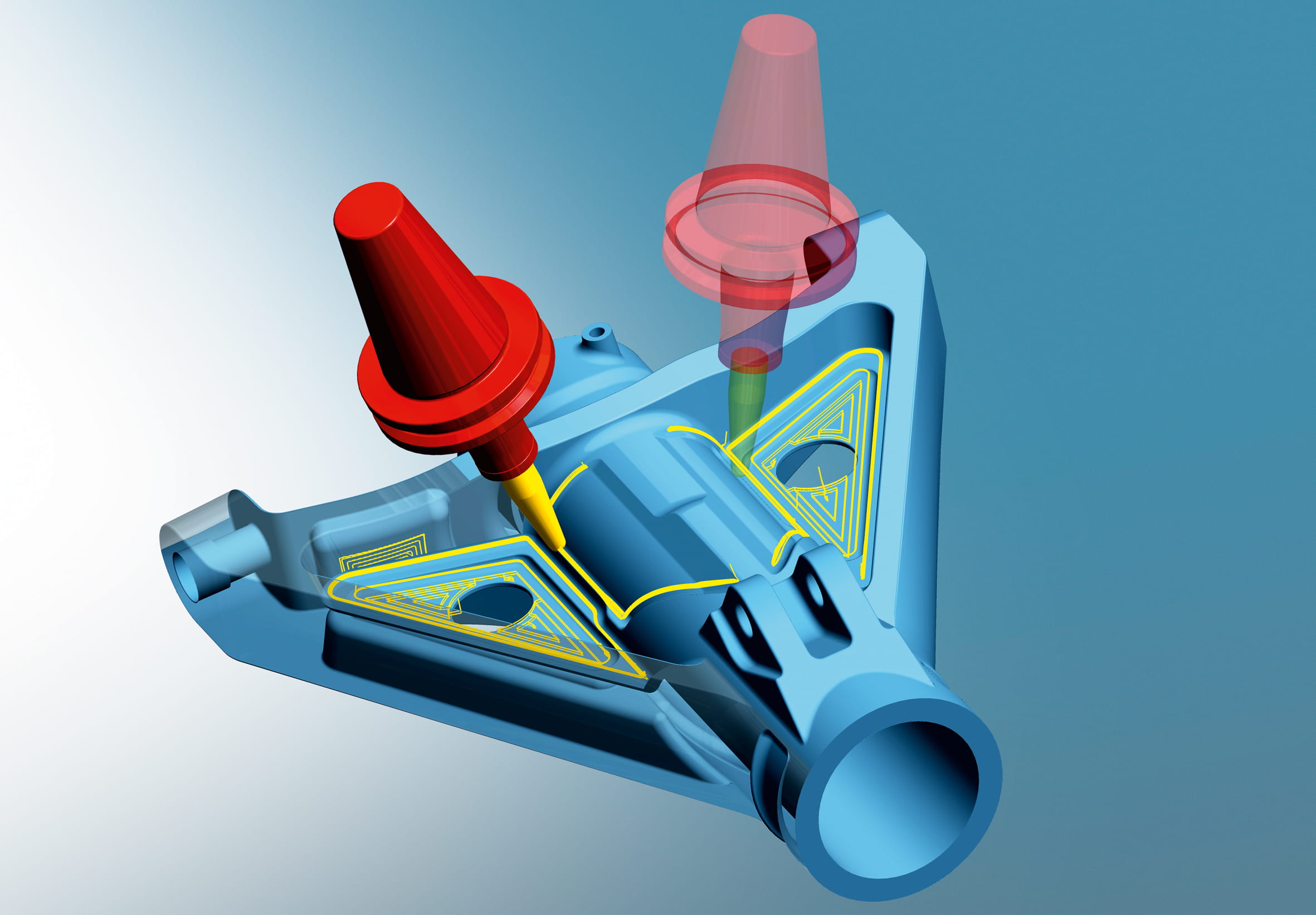

As Dormer Tools Machining Applications Engineer, Mr Matt Johnson comments: “We are currently machining a structural wing component from titanium for an OPEN MIND and Dormer customer. Like the OPEN MIND customer, we are using the same Dormer S357 12mm carbide cutter with a 3mm radius and we extended tool life from 30 minutes to over 2 hours – a tool life improvement of over 200%. The only difference is that we are using hyperMILL® MAXX Machining.”

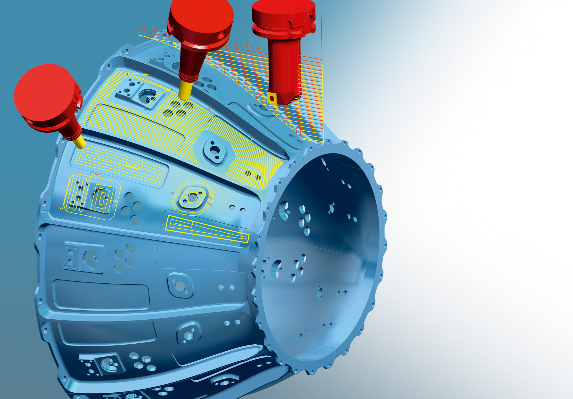

hyperMILL® MAXX Machining: Aerospace aluminum structure part
This aerospace aluminum structure part was programmed with hyperMILL® and its innovative and powerful CAM strategies. An incredible machining time of only 2 hours and 15 minutes has been achieved due to our high-performance strategies like 5-axis tangent plane machining, 5-axis helical drilling and Linking-Technology.
Material: Aluminum
Machine: GROB G550

With regard to the production of the structural aerospace part, the customer was taking 40 hours to ma­chi­ne two sides of the component, this is now 10 hours with hyperMILL® MAXX Machining. As Mr Johnson states: “The aerospace subcontractor has a contract to produce over 150 parts that was taking close to a week to machine each part. To demonstrate cycle time reduction with hyperMILL® MAXX Machining, one pocket was previously machined in 40 minutes. Dormer is now milling the pocket in 3 minutes. To achieve such a result and simultaneously improve tool life is exceptional.”
The implementation of hyperMILL® MAXX Machining at the test facility within the AMRC is yielding sig­ni­fi­cant benefits for aerospace subcontractors and OEM‘s alike, especially when machining aerospace grade materials such as 6LV-4 titanium, Inconel and other exotic austenitic alloys.
