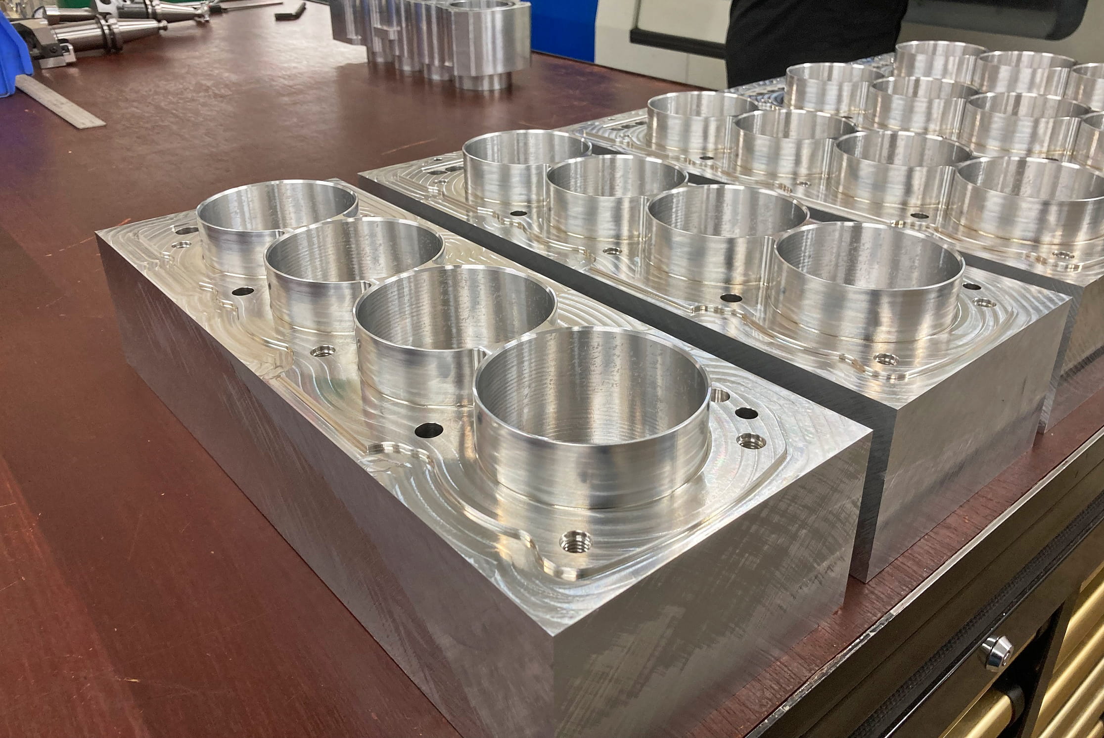

HSM Components encountered several challenges with the motorcycle engine block, such as machining water jacket slots around the cylinder bores as well as the machining of a pocket at the end of the cylinder head for the cam chain. The water jacket slot is 6mm wide and 50mm deep. The pocket for the cam chain goes all the way through the engine block and has tapered walls. Both required specialist tooling and creative machining strategies that were a breeze with hyperMILL®.
Commenting upon the project, HSM Components Managing Director Steve Rigby says: “This customer is a specialist race engine builder that we already manufacture several products for. They brought a new project to us to manufacture small batches of 5-off cylinder blocks to meet the requirements of its global customer base. Previously the company had been using overseas manufacturers with a minimum batch quantity of 10 off and a longer lead time. By working with HSM Components, this customer can reduce their order volume, inventory and lead times.”
![–](/fileadmin/_processed_/1/0/csm_hypermill-toolpaths-in-slots_2a01446317.jpg)
“With regard to the aluminium engine blocks, each block requires 10 hours of machining with four individual setups. To support this project, we had to manufacture special fixtures, acquire bespoke tooling from Quickgrind and adopt a leading CAM system from OPEN MIND, but the benefits for the customer have been significant.”
Machined on a 3-axis Hurco VMX42, programmed with hyperMILL® and subsequently adding specialist cutting tools - this combination has helped HSM Components to minimise the cycle time for these challenging engine blocks. Concluding on the project, Steve Rigby says: “We initially completed three engine blocks as a trial for this new customer and by improving the quality and lead time of these parts, we are now working on another batch of five engine blocks. The tool paths with hyperMILL® are also improving our surface finishes. The opportunity for HSM Components is to now manufacture additional components for this customer that sells spare parts and builds bespoke motorsport engines for everything from grass track racing and hill-climbing to performance vehicles that are exported worldwide. By utilising the high-end hyperMILL® CAM system in conjunction with the specialist cutting tools from Quickgrind, we have little doubt that we can facilitate all the needs of this client.”
