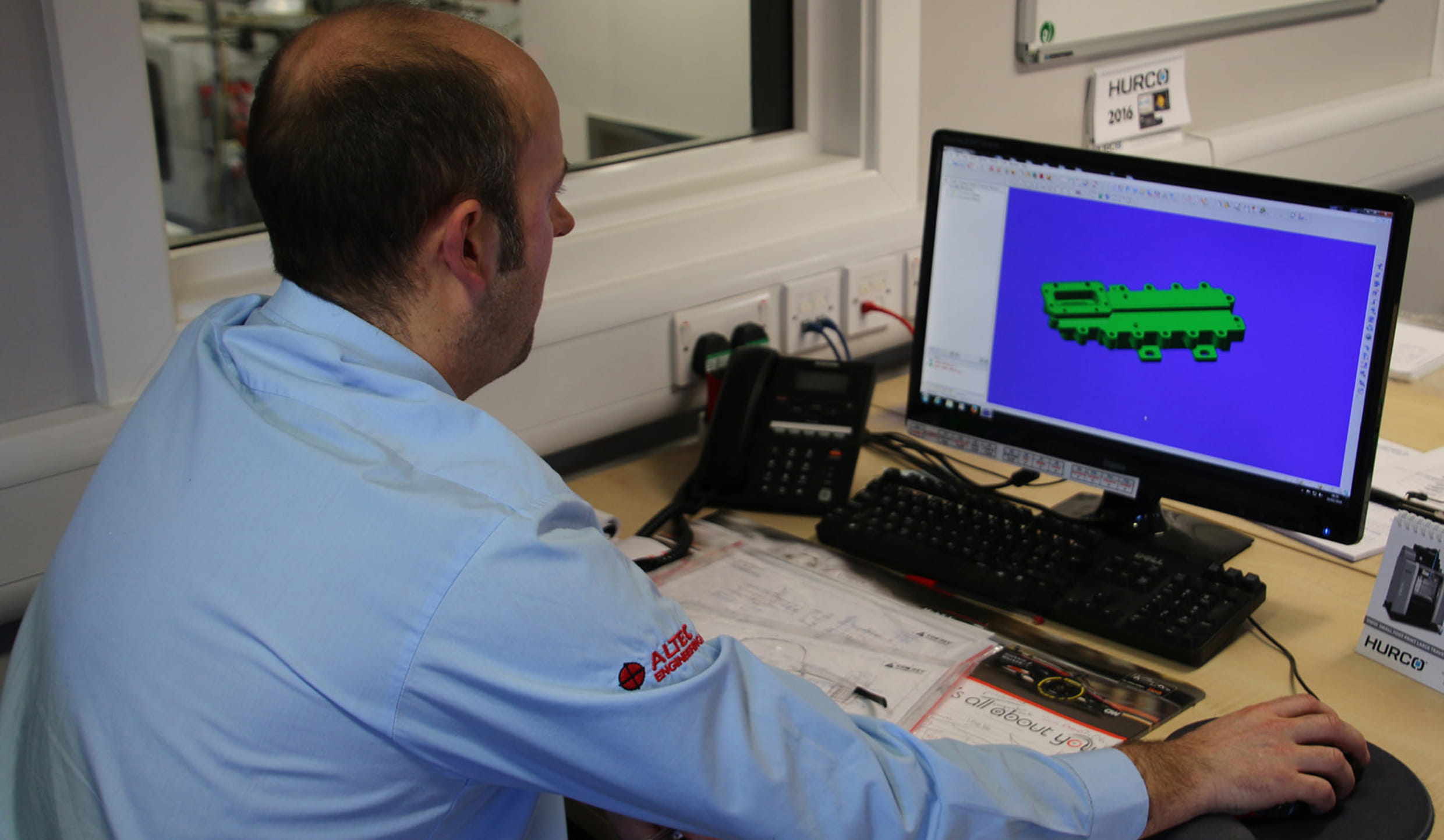

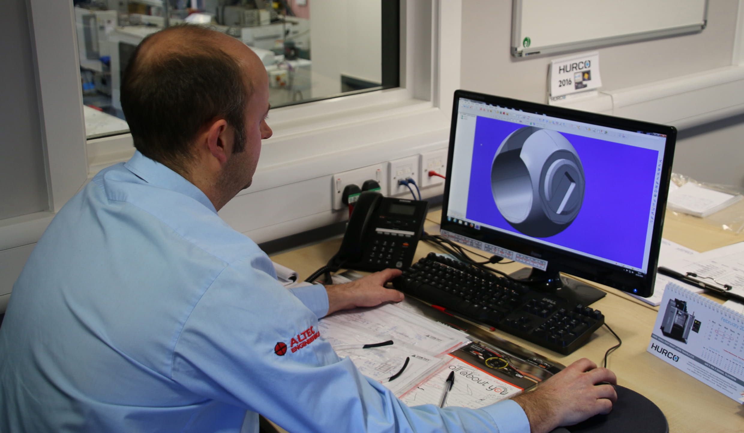

Many Altec customers provide the company with digital models that the company instantly drop into hyperMILL® to generate a part program. Once the component is programmed it is anti-collision checked and then sent to the shop floor for production. Commenting upon this, Mr Powell continues: “Firstly, by receiving the digital files we can rapidly simulate the part and calculate a machining time. This fast calculation is given to our sales team to provide accurate quotes for the customer. The combination of productive 4 and 5-axis machine tools and optimised cycles through hyperMILL® are primary reasons behind our easy transition into new sectors and our ability to win business in a competitive industry.” Prior to sending part programs to the shop-floor, the programmers select the machine tool, workholding fixtures and toolholding configuration for the job. These are all simulated in hyperMILL® to eliminate collisions and optimise the process and toolpaths. To guide operators on the shop floor as well as the inspection department, the programming team use the hyperMILL® 'Smart Dimension' feature to dimension the model and provide a fully detailed print-out to staff involved in downstream processes.
