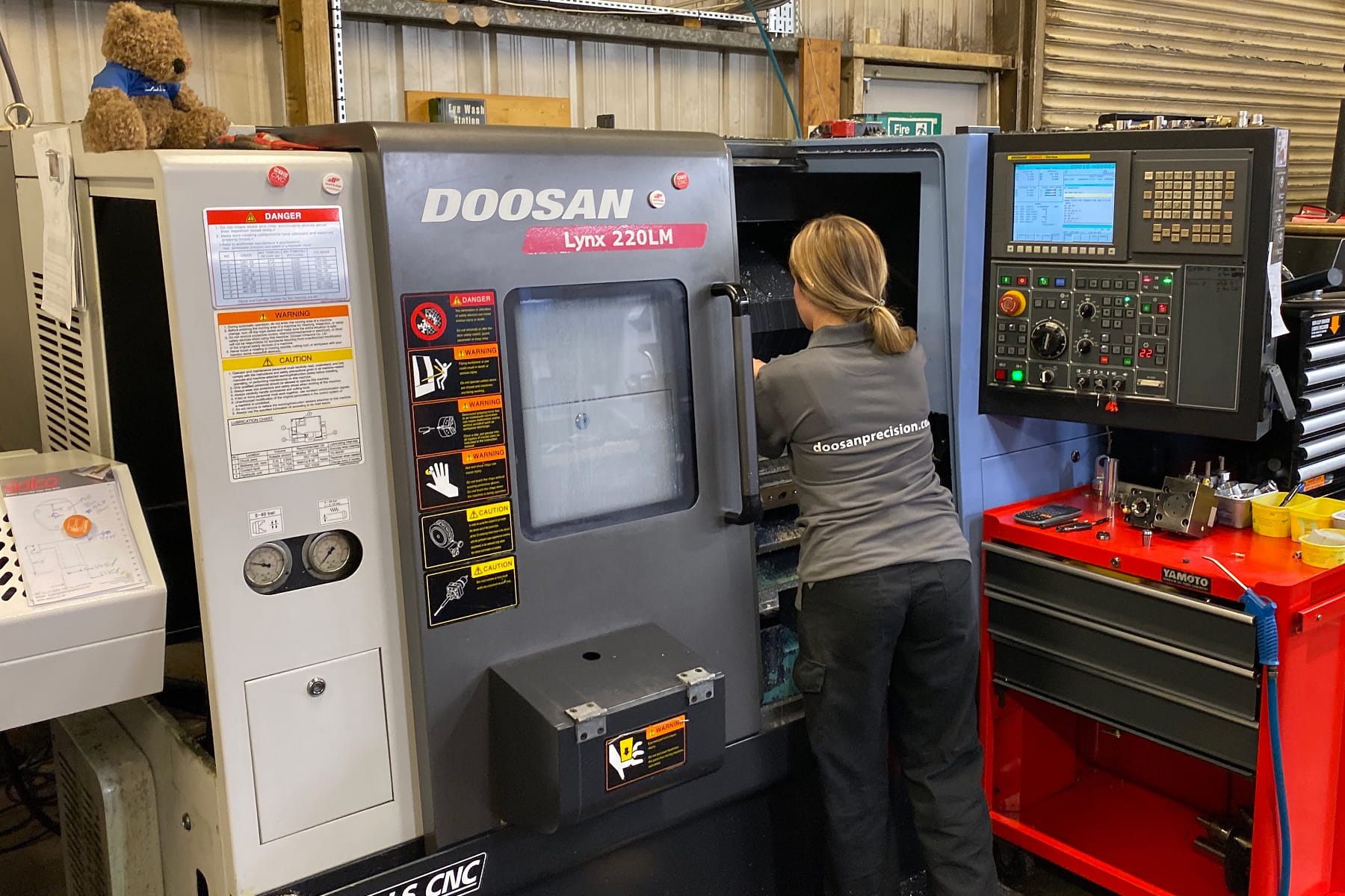

Although no relation to the Doosan machine tool brand, the company has invested heavily in the Doosan machines from Mills CNC. The company name is actually a culmination of Directors family names. The ISO: 9001 certified company has a plant list that includes a Doosan DNM 500 machining centre with a 4th‑axis, plus five turning centres that includes the Doosan LYNX 300M, Doosan LYNX 220LM, two Doosan LYNX 220 LSYC machines and the newest arrival, a 9-axis Doosan MX2100ST. As a machine shop primarily conducting turning activities, Doosan Precision Engineering isn’t typically a facility where you would expect to find hyperMILL®, the industry’s leading 5-axis CAM software from OPEN MIND Technologies.

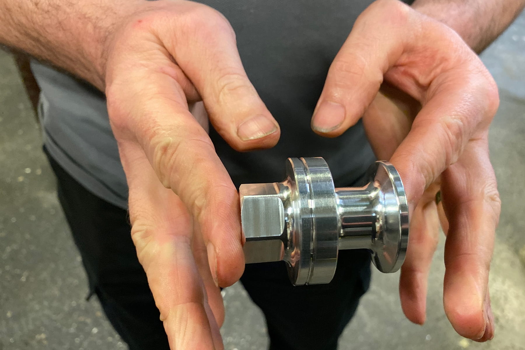

Referring to how hyperMILL® has revolutionised the business, Mr Booth continued: “hyperMILL® has reduced the setup times massively. Some parts were taking 4 to 5 hours to program and set, the new CAM system has now reduced this to as little as 30 minutes in many cases. OPEN MIND is well respected as an industry leader in 5-axis milling technology, but we specifically bought it with turning in mind. We have one part that was originally manufactured using grooving tools to machine the scallop at the back as well as other fe­a­tu­res. Unfortunately, the challenging material demonstrates poor swarf control, now we use hyperMILL®, we can use a single button tool and the job comes off the machine completely finished.”
“The decision to use this single tool configuration was decided by hyperMILL® CAM software. The software selected the best strategy to control swarf and reduce the cycle time, which reduced massively when com­pa­red to the previous value.”
