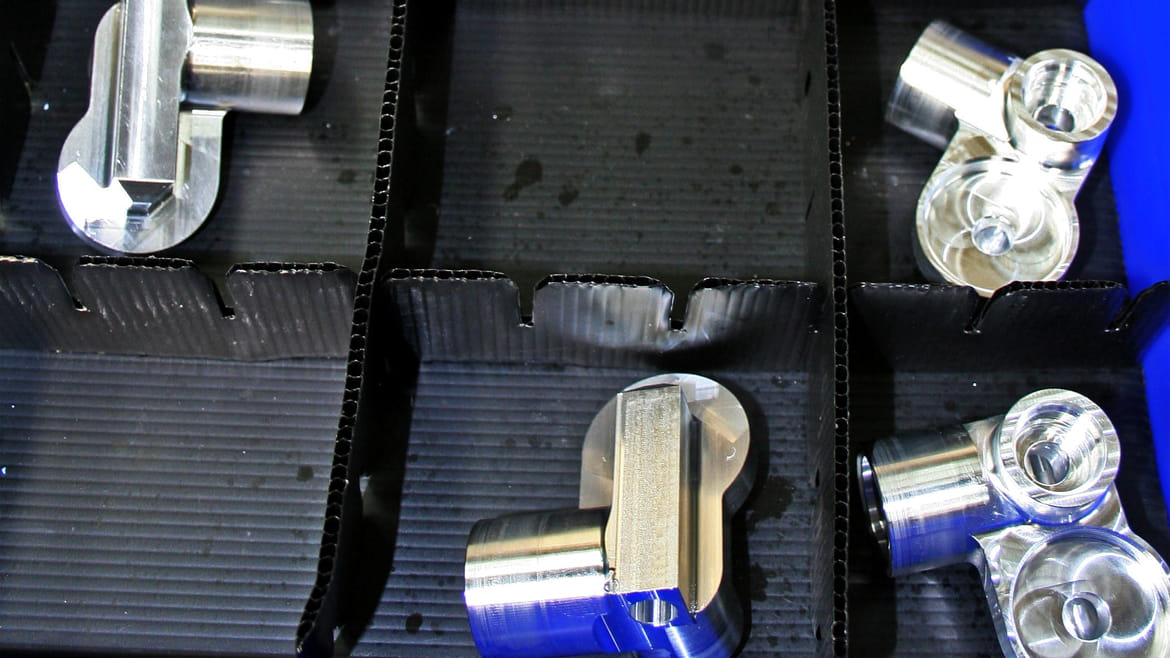

Complex drill heads for the oil and gas industry
As Mr Long continues: “We witnessed immediate benefits with hyperMILL®. We produce a number of different complex drill heads for the oil and gas industry. However, the hyperMILL® system has feature recognition and it allows us to program 50 holes at any geometry in minutes as opposed to hours. We have taken the programming time for drill heads from 10-20 hours to less than 6-8 hours with the feature recognition tool on the hyperMILL® system.” From drawing to complete part the drill heads previously took over 30 hours, with hyperMILL® the overall production time has been cut by around 50%.

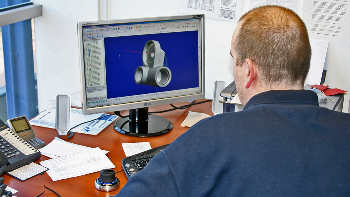

Instead of having a man and machine on-stop, parts can be programmed in the office whilst the machining centre is running.

Another major benefit of the OPEN MIND system to Long & Marshall is the ability to conduct programming off-line. The hyperMILL® system enables the company to verify its tool paths and watch the part being cut on-screen and in such detail it highlights any issues prior to the program being loaded to the machine. With less time spent programming on the shop floor, the machine tools spend more time conducting actual machining than on-stop being programmed. Reflecting upon the OPEN MIND acquisition, Mr Long states: “Our accuracy, productivity and surface finishes have all improved since purchasing the OPEN MIND system.”
