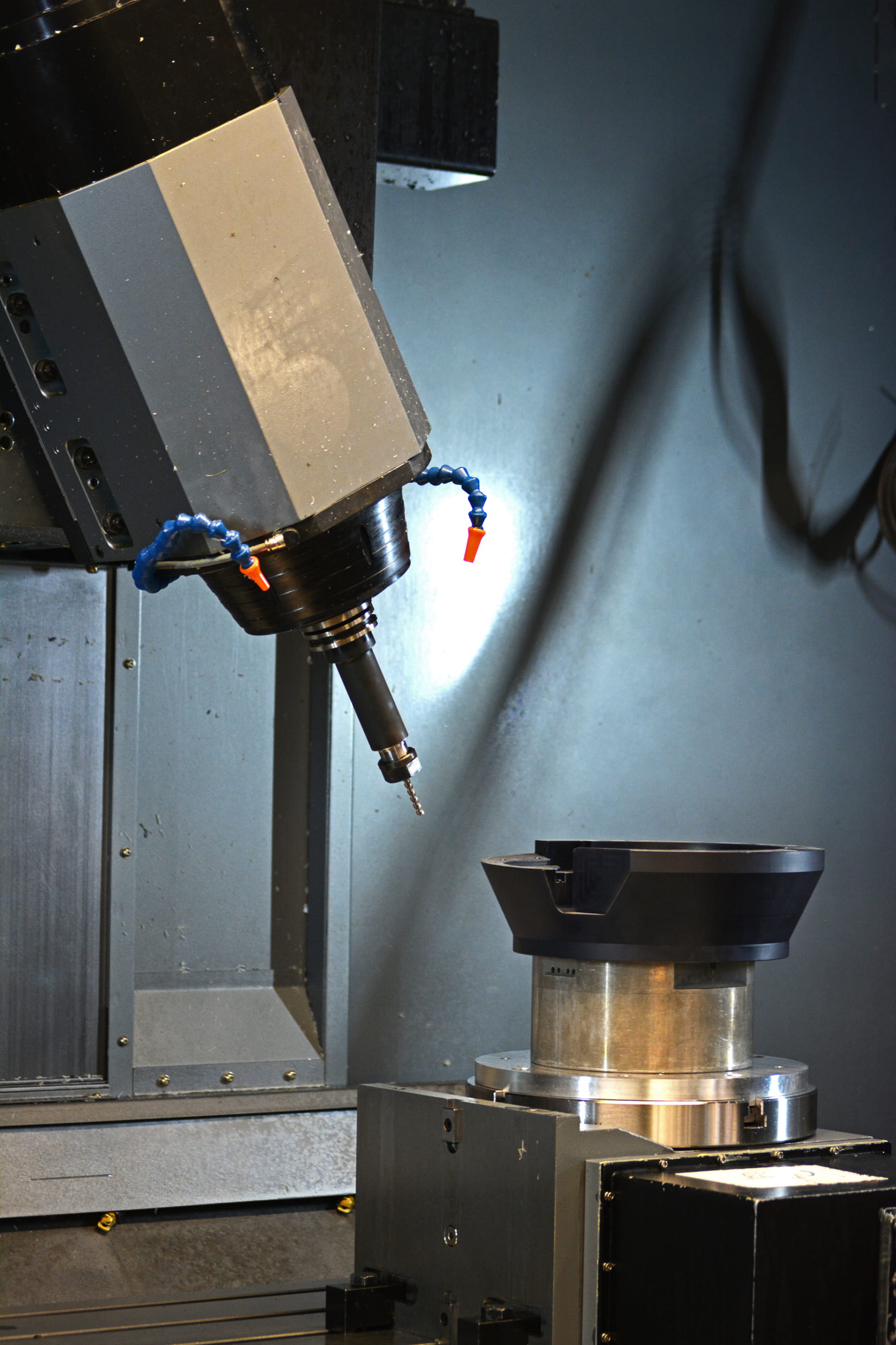

”According to Davies, moving into 5‑axis was a necessity for growing the business. And the company did this through the purchase of a Hurco VMX 60 SWi swivel-head 5‑axis machine. “We needed 5‑axis ma­chi­ning in order to take our machined feeder technology to the next level,” said Evan Gilles, lead mechanical designer at VTR. “Complex machined bowls, one-piece tooling sections, twist tracks, and spirals would not be feasible without 5‑axis technology. The machine has the unique ability to be used in either A/B or B/C axis configurations, which allows us the flexibility to machine a variety of components. For example, a ma­chi­ned bowl works best in the B/C configuration, but a spiral works best in the A/B configuration.”

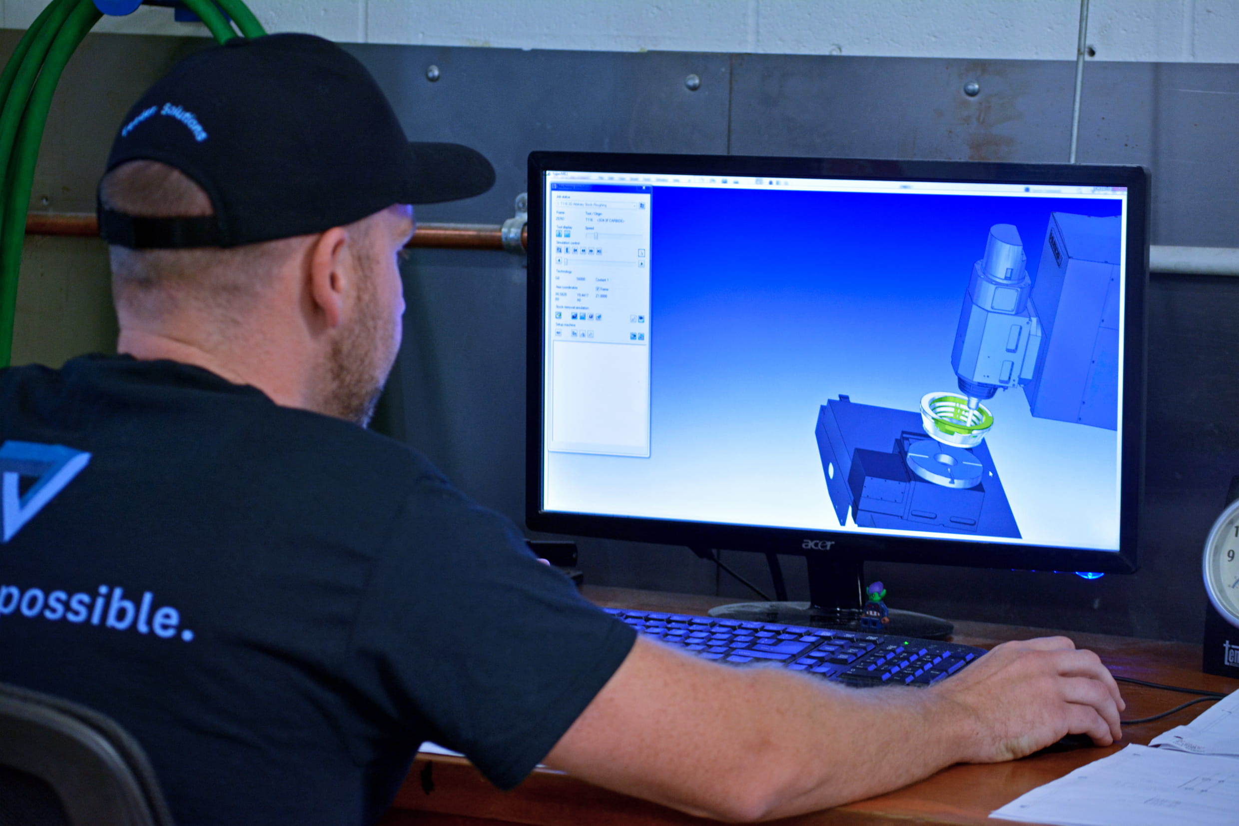

“The challenge was that we did not have anyone with 5‑axis experience,” explained Gilles. “Because of hyperMILL®’s direct integration into SolidWorks, it was easy to pick up because programming is done directly on the SolidWorks model with an interface that the users were already familiar with. The CAM software’s 5‑axis cycles were also exactly what we needed for machining our parts, which made learning much easier.”
Keelan McKillop programs a feeder bowl in hyperMILL® CAM software.
