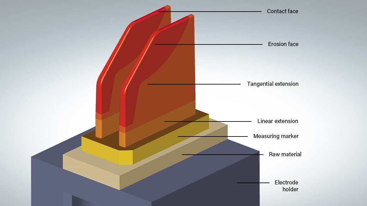

  • Suitable for solid and face models
  • Geometry selection through face and contour selection
  • Automatic extension of electrode geometry
  • Holes in the geometry can be automatically closed
  • Measuring markers for the electrode
  • Automatic color and layer definition for the individual electrode areas
  • Automatic raw material and holder selection with best-fit option for optimal alignment
  • Automatic stock calculation and collision avoidance
  • Electrode reference as chamfer or radius
  • Detailed reports
  • Incorporation of manually created electrode geometries into the automated process
  • Automatic calculation of the minimum rib distance
  • Automatic calculation of the length and adjustment options for the length of useless raw material

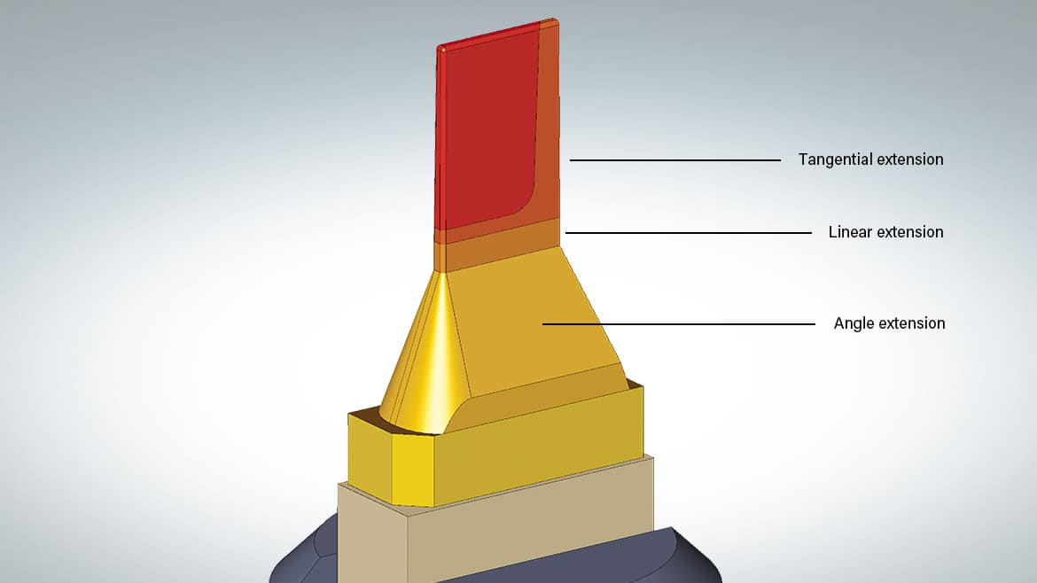

Geometry extension
Automatic tangential or linear extension of the electrode geometry. Angle extension is also available for stabilisation.
