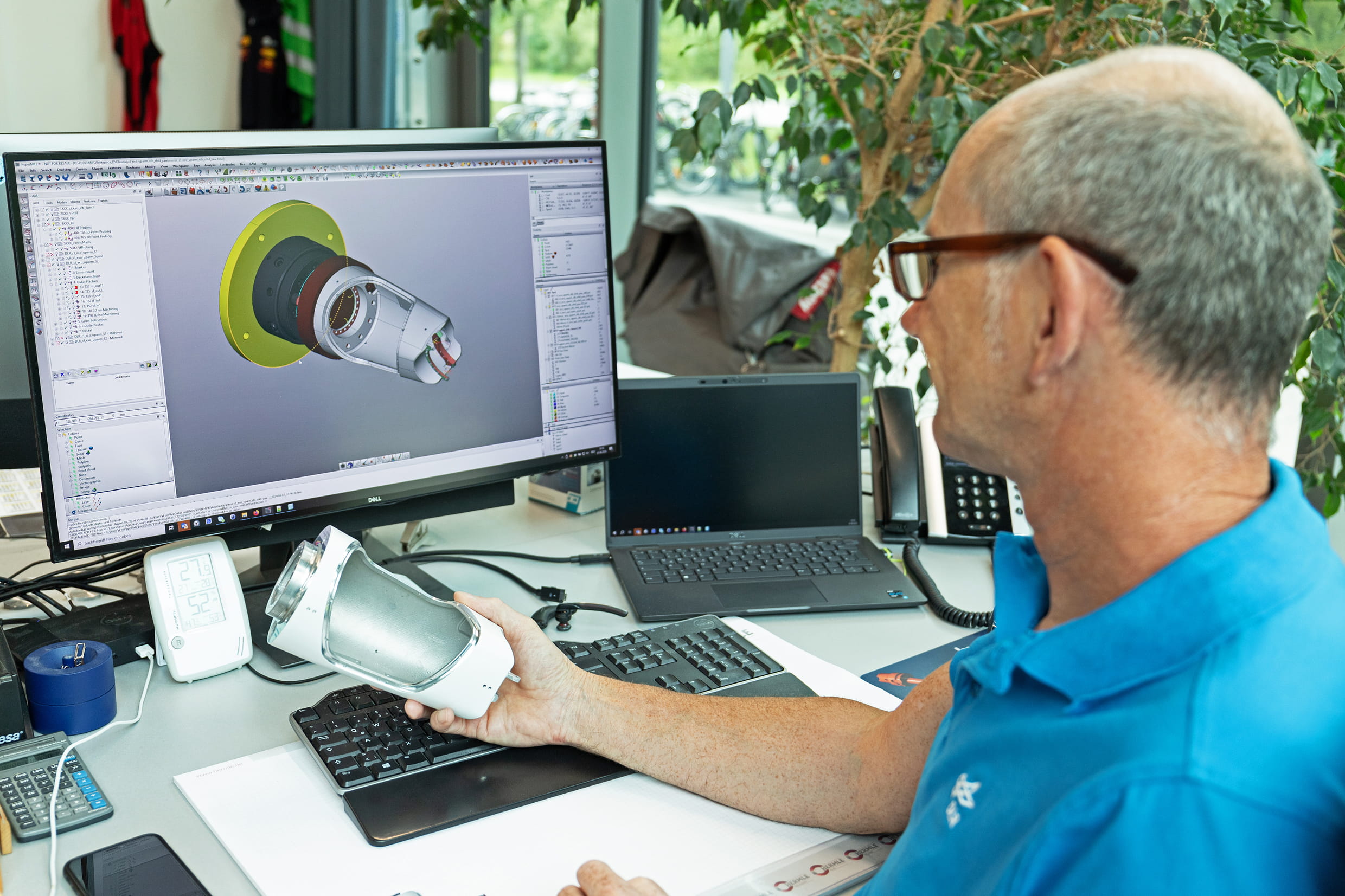

Dreer is very enthusiastic about hyperMILL® VIRTUAL Machining (VM) that he added a year later: “This gives me a complete package from OPEN MIND that generates perfect NC codes and ensures almost one-hundred-percent collision-free machining thanks to precise NC code simulation.”
NC code simulation is nothing new in mechanical production at DLR-RM. Dreer and his colleagues consider it absolutely essential for five-axis machining: “The risk of a collision is simply too great. Even a well-established programmer with lots of experience can never predict with certainty what machine movements will actually look like. It’s not enough to simulate with pure CAM data.” This is why Dreer and his colleagues have been using separate simulation software for NC code simulation for some years now.
This was also initially used with hyperMILL®. Dreer sees this as a step forward: “Compared to our previous CAM software, hyperMILL® offers a better interface and easier data transfer. Everything is much faster now that we have the NC code simulation in the hyperMILL® VIRTUAL Machining Center. We have an end-to-end workflow, as hyperMILL® automatically makes all process-relevant data available. In no time at all, I get feedback on whether the program is running on the machine without collisions or not – with almost one-hundred-percent reliability.”

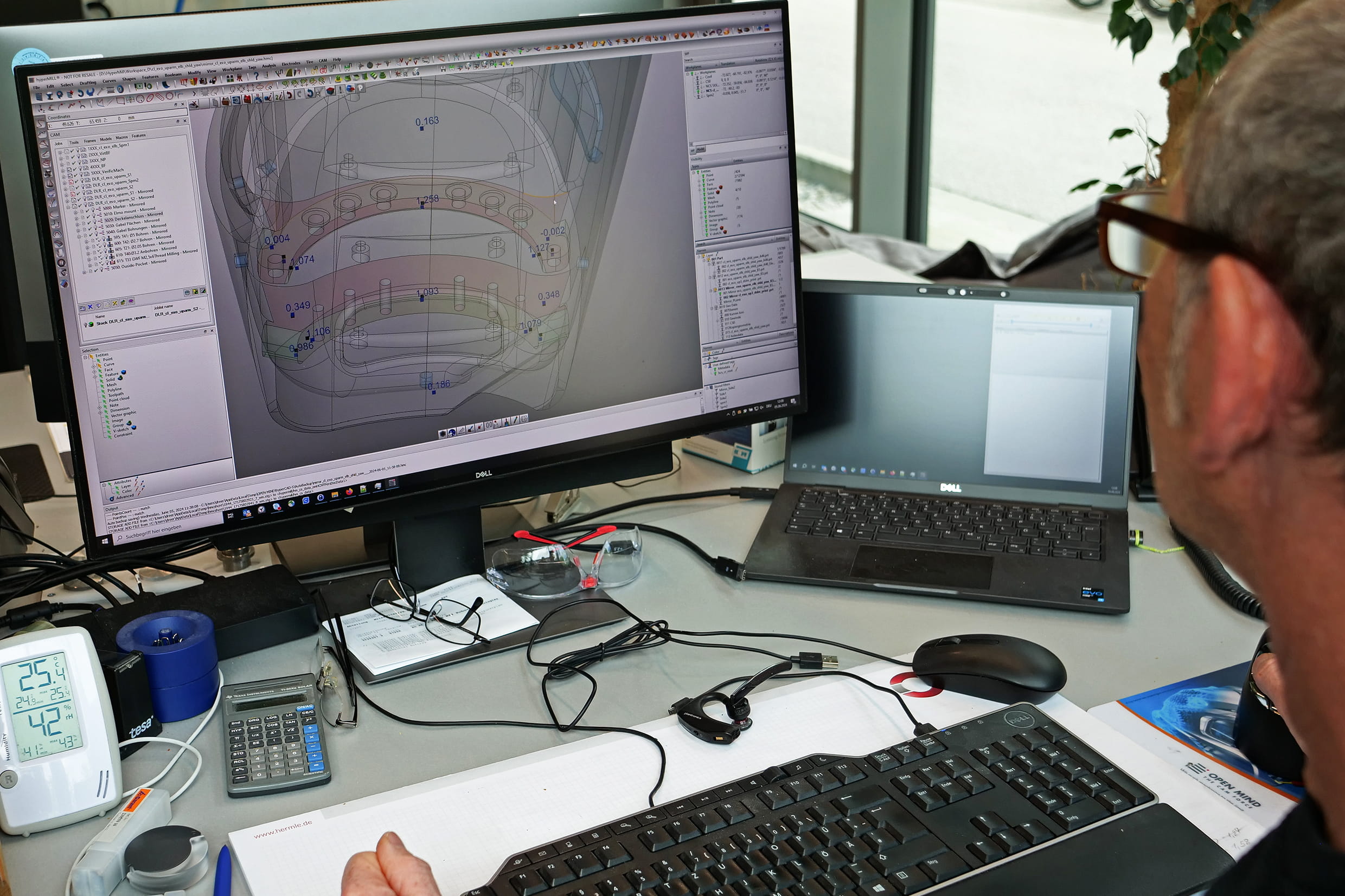

hyperMILL® VIRTUAL Machining also includes the Optimizer module in addition to NC code simulation. During NC code generation, this adapts the NC program perfectly to the kinematic properties of the machine automatically. The best positions are selected and optimized, linking movements are generated between individual operations. Michael Dreer uses the Optimizer primarily for job linking: “This function links my individual jobs with safe, optimized, and collision-free movements without me having to worry about it.”
While the DLR-RM production team saves programming time with the Optimizer, the BEST FIT function, available as an add-on for hyperMILL® VIRTUAL Machining, reduces the time to clamp and align the component. “In the past, we had a material removal volume of over 90 percent for our lightweight structures, which is why we now have these components manufactured using 3D metal printing or investment casting wherever possible,” explains Michael Dreer. “However, we also have to machine functional surfaces, drill holes, and threads on these parts.”
One difficulty was clamping the parts on the machine and aligning them precisely. This required complicated clamping devices and an enormous amount of time, as repeatability had to be achieved for subsequent parts. “With BEST FIT, we have found a way to set up parts quickly and machine them reliably,” says a delighted Harald Wagner.

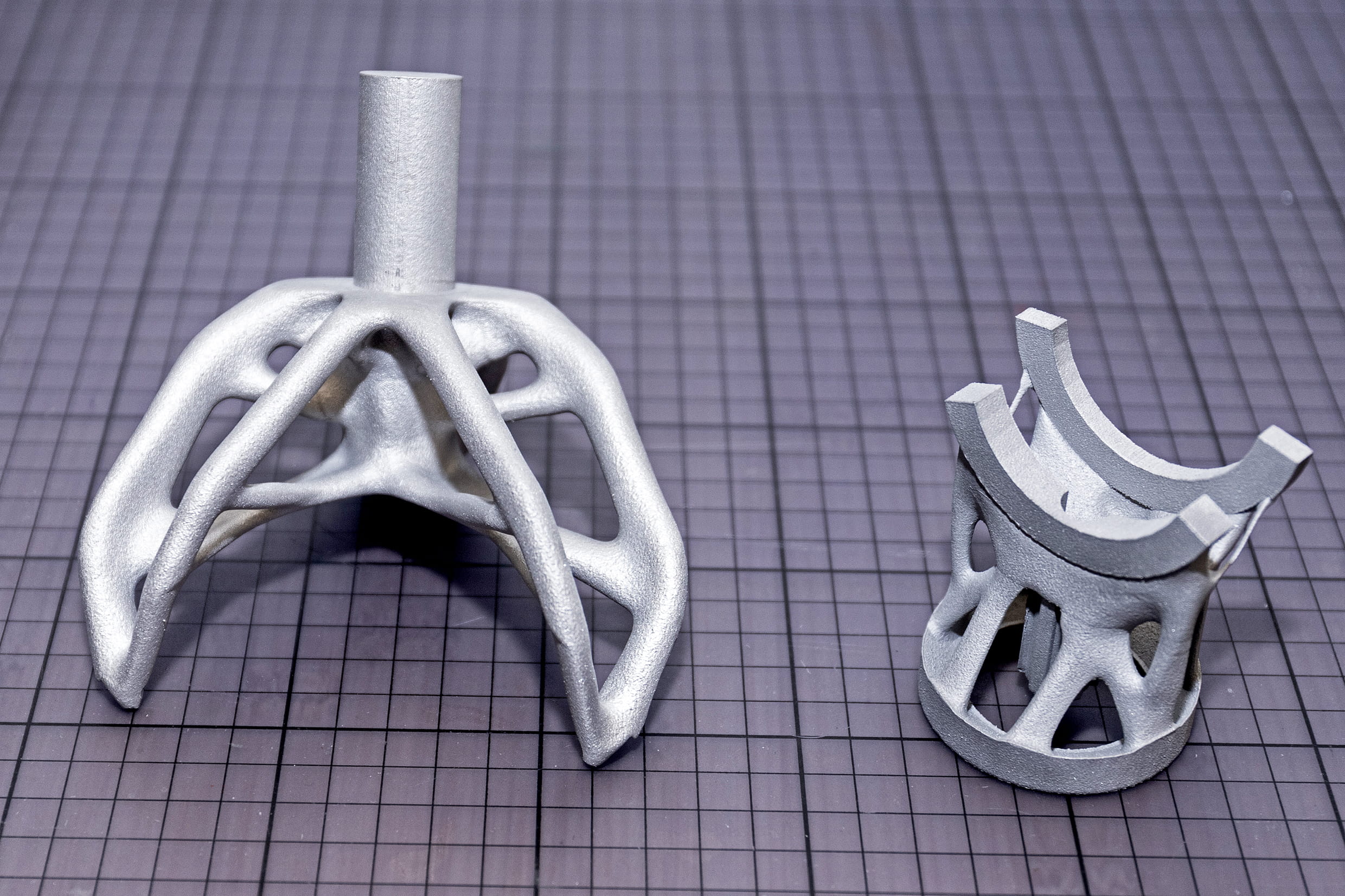

 – If the components are produced additively, they can be extended to include construction aids. These are also printed and make it easier to clamp on the machine tool later on. After complete machining on several sides, they are separated again.

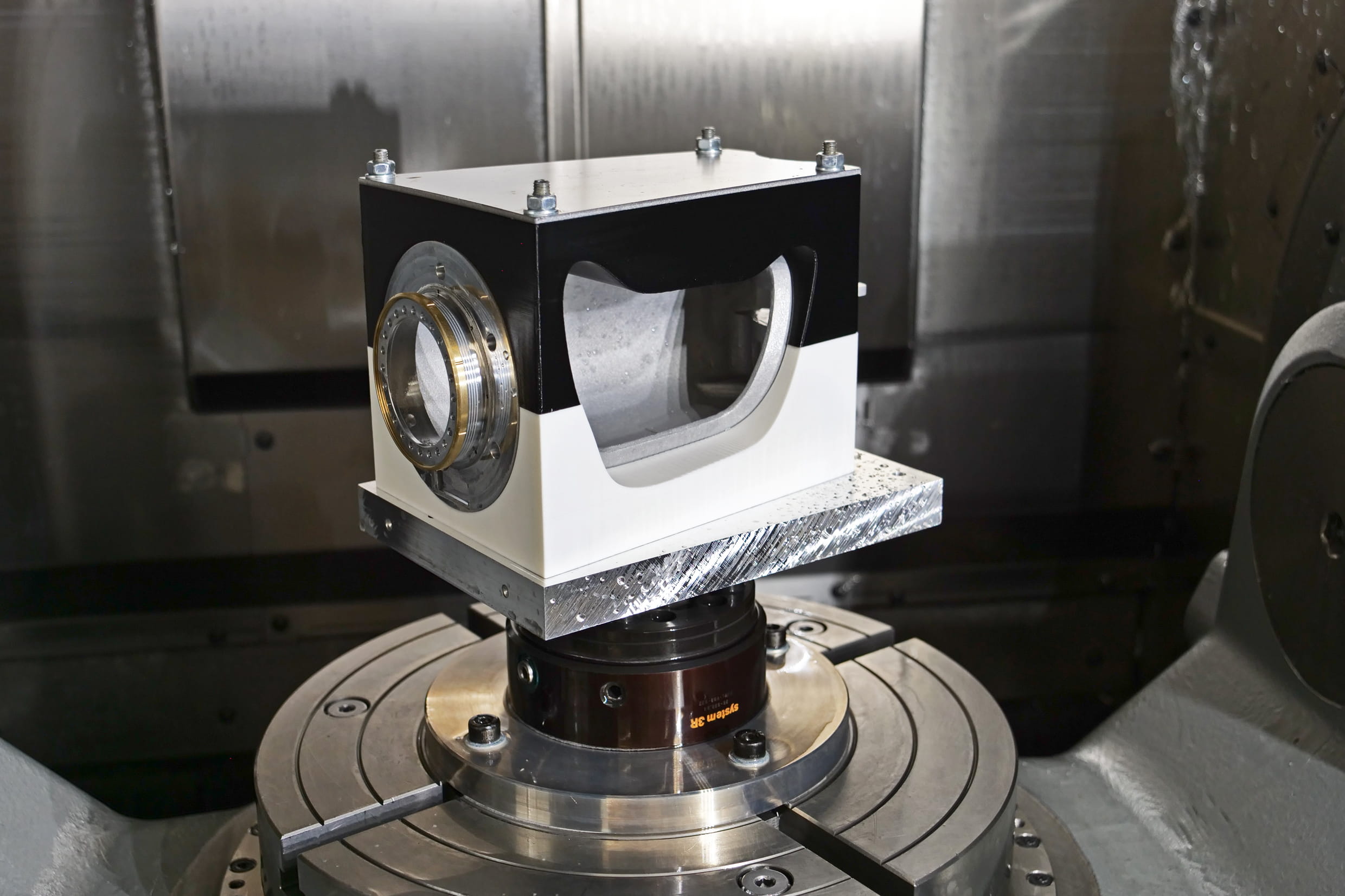

BEST FIT is an intelligent component alignment function in the CAM system that allows the component to be fixed to the machine without being aligned. “We use inexpensive, printed plastic fixtures for this, for example,” says Michael Dreer, “as when clamping, it doesn’t come down to the millimeter.” The component is then measured on the machine with a 3D touch probe. The results are sent back to the CAM as a measuring log. hyperMILL® BEST FIT then moves the CAD component so that it is completely within the measured stock.
“I can check this on the screen, but it usually fits perfectly straight away.” BEST FIT then modifies the NC code accordingly, simulates it in relation to the actual clamping situation, and optimizes the program automatically. Michael Förster, Senior Product Marketing Manager at OPEN MIND, explains the next steps: “To ensure safe and accurate machining, the machine setter then performs a verification measurement. If the position on the machine matches the optimized program, machining can start without the machine setter having to laboriously align the component on the machine. The advantages include immense time savings, safe machining, and plannable processes.”
 – The production specialists use low-cost, printed plastic fixtures to clamp a forearm structure. Thanks to the <em>hyper</em>MILL<sup>®</sup> BEST&nbsp;FIT function, the component can be fixed to the machine with these shells in an unaligned position.
The production specialists use low-cost, printed plastic fixtures to clamp a forearm structure. Thanks to the hyperMILL® BEST FIT function, the component can be fixed to the machine with these shells in an unaligned position.
