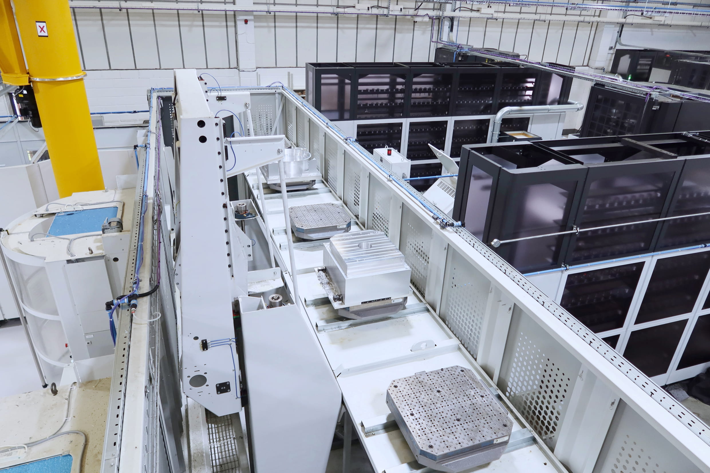

The next step for the Hampshire company is to increase its throughput and workflows through automation. Unlike most subcontract manufacturers, RE Thompson already has impressive factory floor automation with a remarkable 512 pallets on just nine machining centres. The bottleneck for RE Thompson has been the process flow away from the factory floor – primarily CAM programming.

On the factory floor, the company produces everything from 1-off and small batches to runs of hundreds of parts. Turning naturally has higher production volumes, but some milling jobs can be up to 500-off a year of very complex parts for some clients. Parts are processed with utmost efficiency due to the company’s investment in 512 pallets that are either integrated via machine tool suppliers like DMG MORI or through automation specialists Fastems. With no difference between complex and less complex parts. This has enabled the business to run lights out 24/7 since 2008. New business is from the semi-conductor, maritime autonomous vehicle, aerospace enclosure, hydrogen, and EV industries – all requiring ever-faster turnaround times. Some of these companies will only want 20-50 parts each month, with others requiring significantly greater numbers.

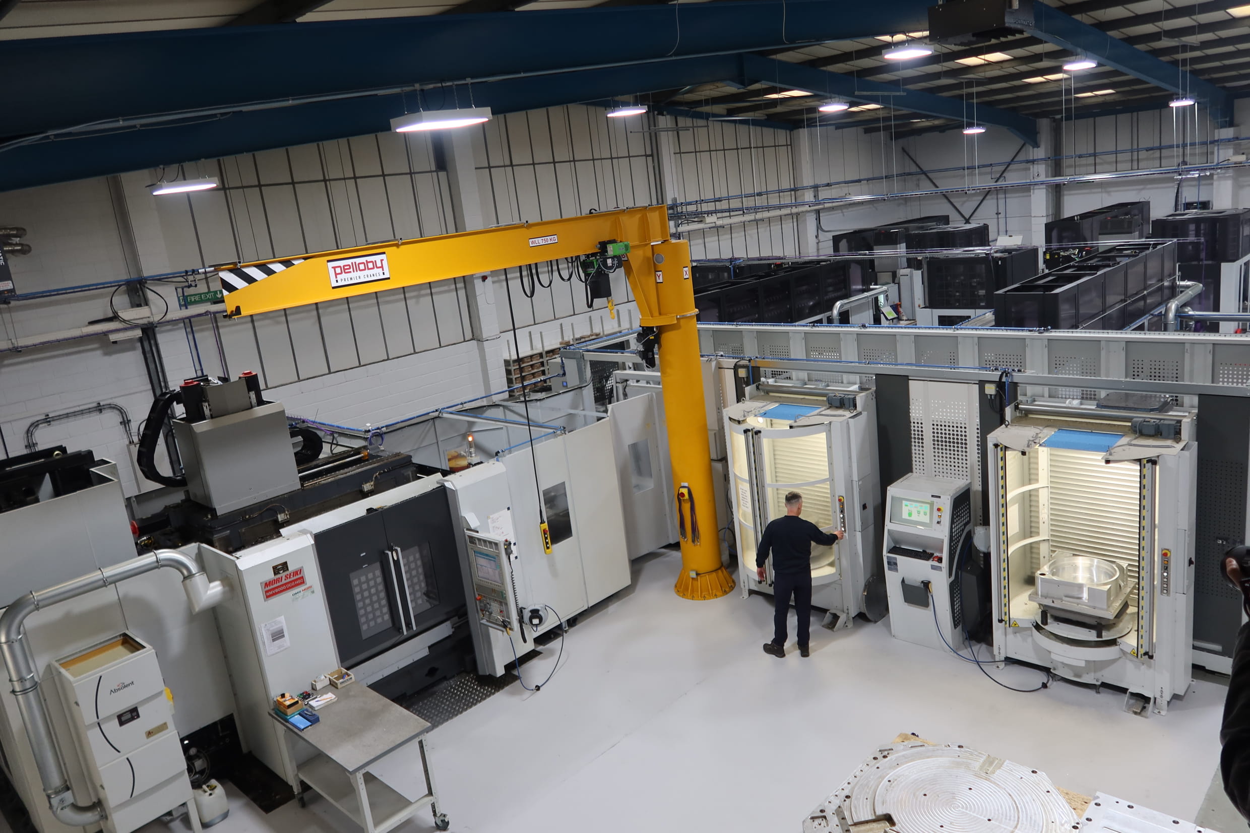

The production floor at RE Thompson with automated cells
