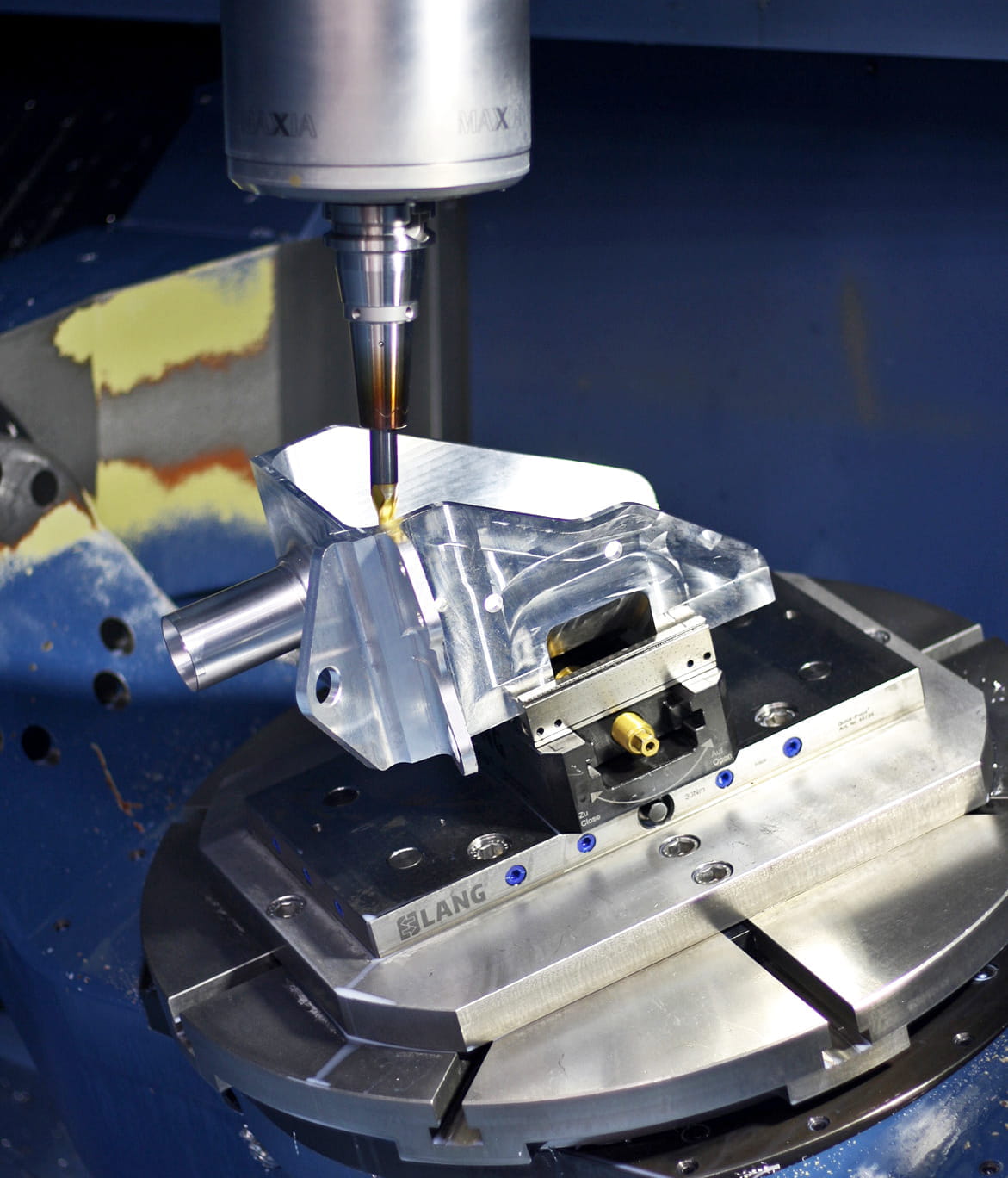

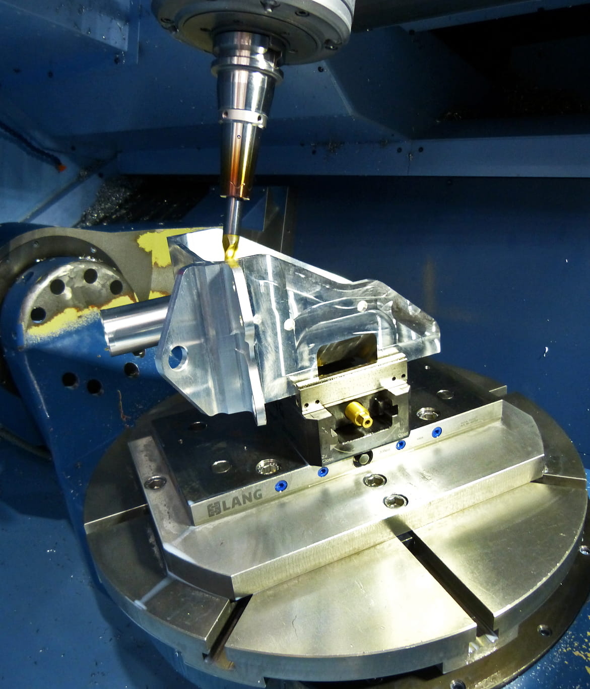

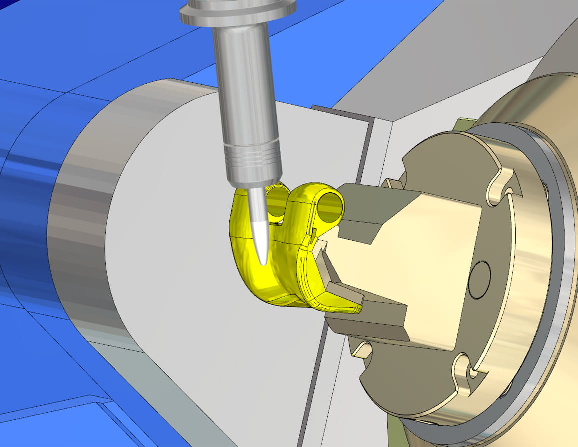

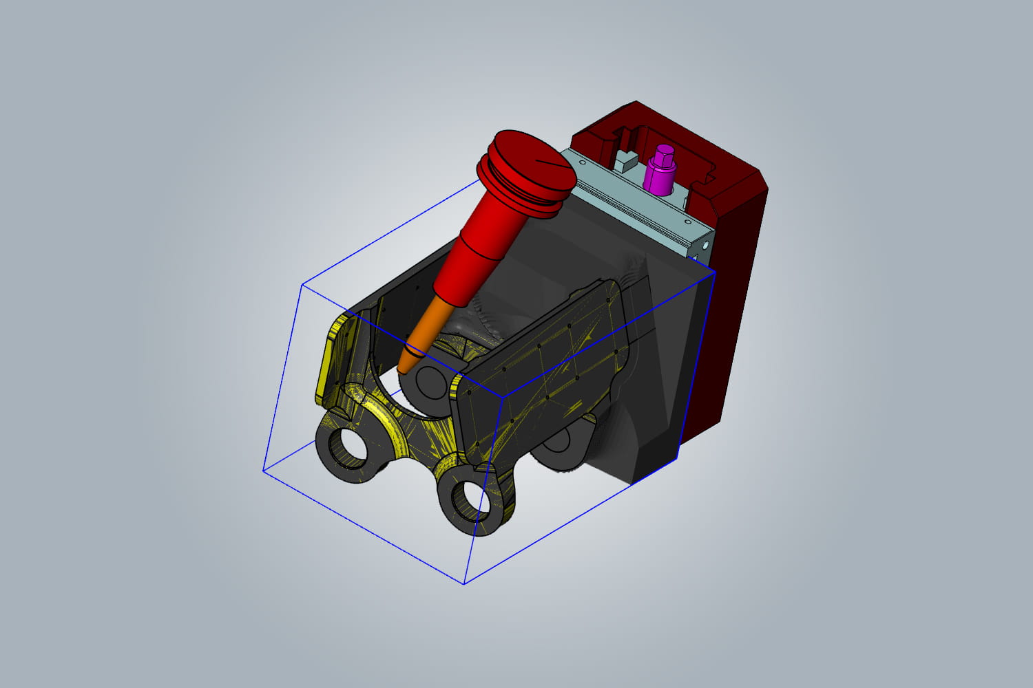

The primary reason Takumi Precision invested in hyperMILL® was the potential of barrel tools to significantly improve productivity. Commenting on this, Gerry says: “The hyperMILL® MAXX Machining Performance Package and the respective barrel tools with their innovative geometry allow us to step-down 5 to 10mm as opposed to 0.4 to 0.8mm when finishing pockets, walls or profiling features. This has instantly reduced finishing cycles by at least 70%, giving us a minimum overall cycle time improvement of 30% on every component.”
However, the benefit is not just the cycle time improvement. “We have historically had a number of staff undertaking finish polishing of parts to ensure our surface finishes exceed customer expectations. Despite the increased speed and step-over rate with hyperMILL® MAXX Machining, the surface finishes are much better than before. This is because the barrel tool has a higher engagement rate that keeps the tool in constant contact with the workpiece.”

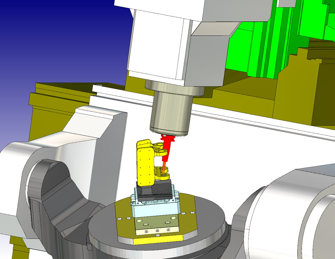

Another feature that persuaded Takumi Precision to invest in OPEN MIND was the mirroring feature. As Gerry continues: “In the aerospace industry, almost everything is manufactured with a left and right hand component. The mirroring feature in hyperMILL® is remarkably comprehensive and with just a touch of a button, we are reducing our programming times on most components by 50%. We have 8 programming staff and the mirroring feature in hyperMILL® is effectively doubling the productivity of this team.”
Better overall CAM system
Whilst hyperMILL® has reduced cycle times on the shop floor by over 20% and reduced programming times by upwards of 50% in the office, the benefits reach much further. “hyperMILL® is much faster than previous CAM systems and it handles ‘big data’ much better than we have previously witnessed. This has eliminated unforeseen PC crashes and massively improved the reliability, processing and delivery of our data to the shop-floor. Furthermore, hyperMILL® has so many ‘obvious’ features and short-cuts that generate savings for the end-user; these ‘obvious’ features don’t appear on other CAM platforms. One feature that simplifies the throughput of programs and parts is hyperCAD®. The OPEN MIND CAD system that is integrated into hyperMILL® is an excellent platform that has now eliminated our reliance on CAD packages like Inventor. We can now expedite jobs through hyperCAD® to hyperMILL® with seamless ease – yet another feature that is making life easier for our programming team,” concludes Gerry.
