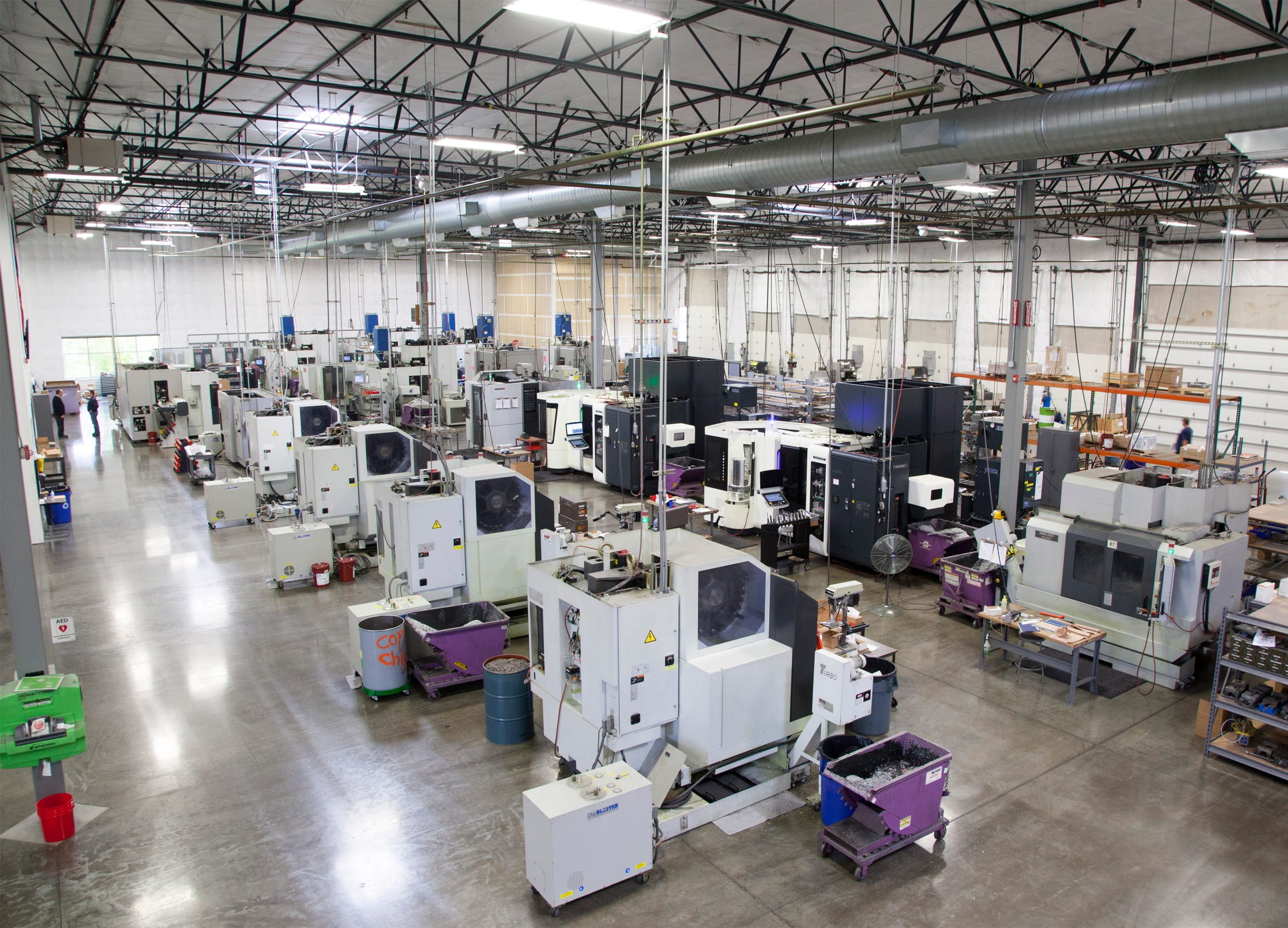

Western Precision Products (WPP) has been a precision machining manufacturer for over 30 years. WPP and its 85 employees handle projects from prototype through production in a high-tech, 48,000 sq. ft. production facility in the Portland, Oregon metro area. Aerospace and electronics make up the majority of WPP’s industries served, in addition to hydraulics, power supply equipment, recreational equipment, semiconductor processing, and testing and measurement equipment.
WPP deploys a variety of machining technology including lathes, mill-turn and Swiss machines as well as horizontal milling and vertical milling centers. The type of parts manufactured spans a wide range from small intricate components to large structural parts. An AS9100 Rev D certified company, WPP’s jobs include manufacturing structural and complex parts for the aerospace industry which often have tight part tolerances and short lead times. Also, aerospace materials range in the thousands of dollars per part, making the risk of mistakes very costly. It is essential to make parts right the first time.

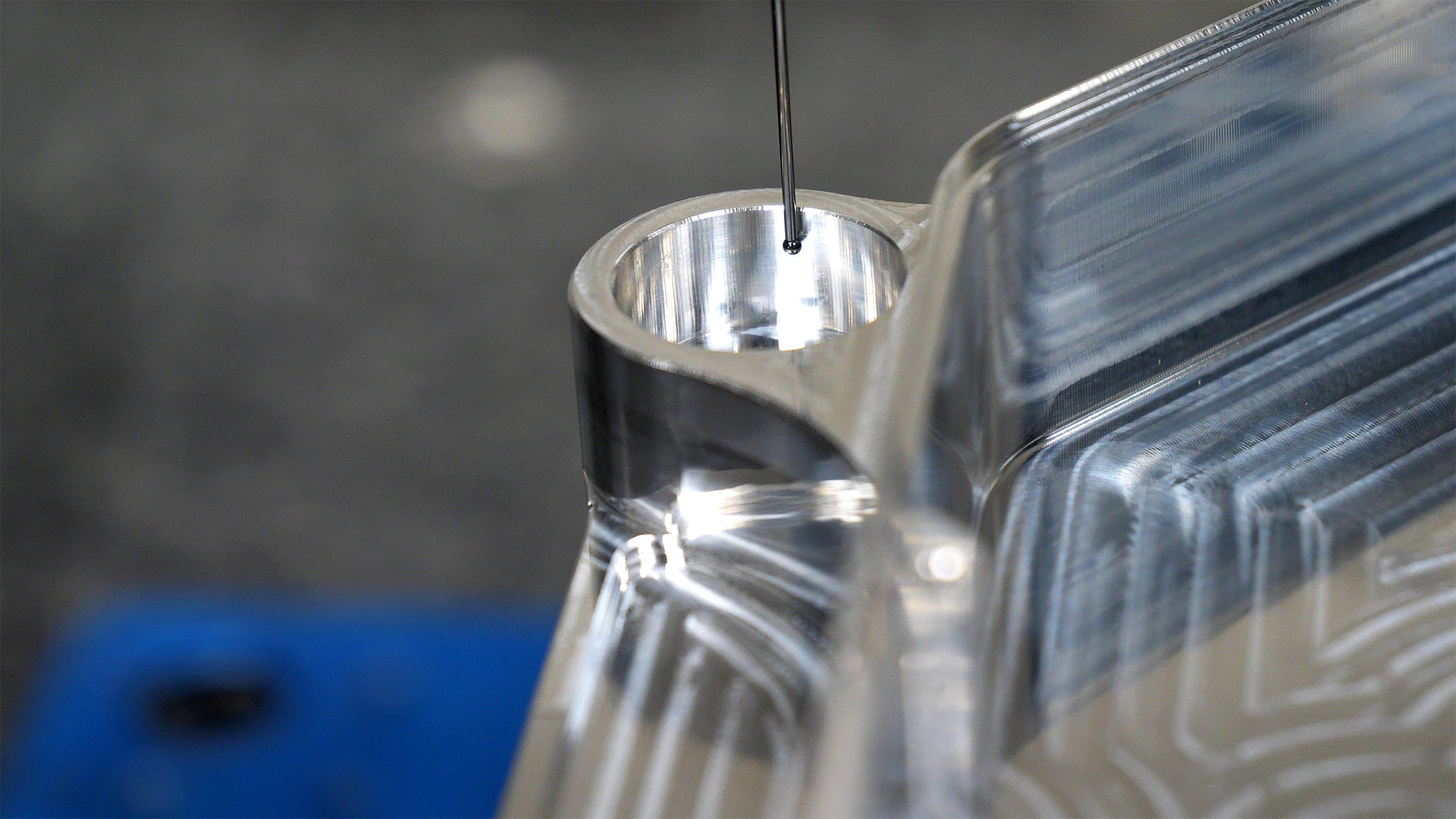

In one example, WPP went from machining a UAV wing spar part on a horizontal machining center to producing the same part on a new DMG MORI 5-axis machining center. They also transitioned from their existing CAM software to using advanced 5-axis strategies in hyperMILL®, and were able to create a better quality part in about half the amount of cycle time than the prior method. Machining strategies now include 5x rework, 5x profile finishing and tangent machining using barrel cutters. “Now the part surface is phenomenal,” said Bureau. Since implementing hyperMILL®, WPP has taken advantage of its automated setup and programming abilities. For example, it is no longer necessary to program drilled and tapped holes anymore because hyperMILL® takes care of it. Bureau said, “We accomplished this by creating a macro database with set rules that look for common characteristics such as hole color, diameter, depth and hole bottom condition, and then make a determination on whether the hole is tapped or not. The macro then pulls the correct tools from the intelligent tool database and automatically programs the holes.”

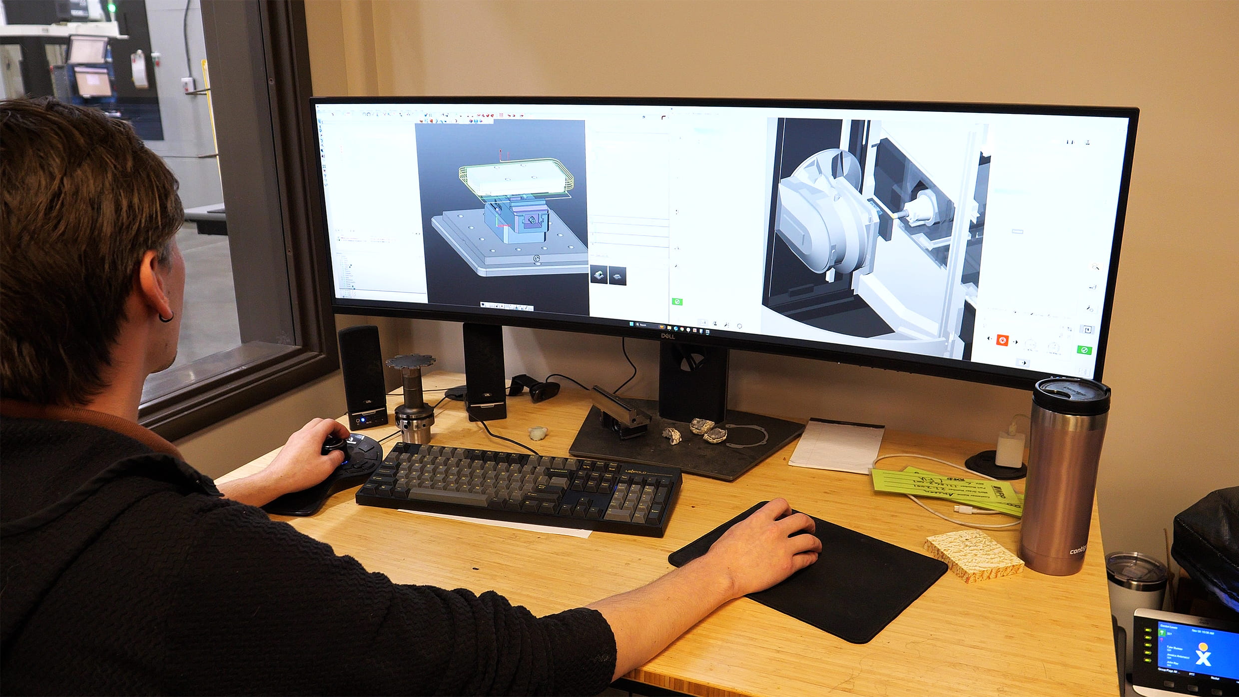

“We have a saying in our 5-axis department ‒ if you can't do it conventionally then use the imagination cycle that has become our nickname for the hyperMILL® 5-axis REWORK cycle,” Bureau said. The hyperMILL® REWORK cycle is a versatile try-out strategy that determines and displays the exact tool path, then adds collision avoidance and control adjustments to achieve it. “It works beautifully,” said Bureau. “hyperMILL® has also helped us improve our Industry 4.0 initiative by allowing us to program the digital twin. We sent OPEN MIND our serialized solid models that match our machine tools exactly, measured our travel limits and now what we see on our screen is what we see at our machine,” Bureau continued.
