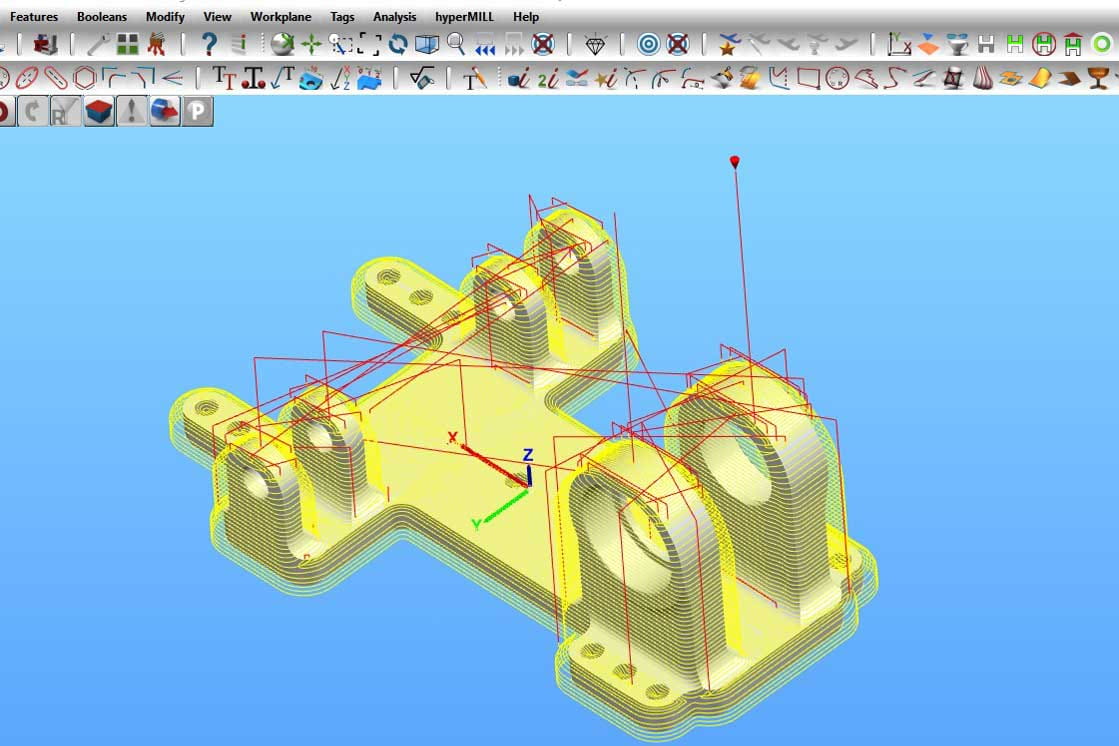

The components machined at Cutting Blue can often have cycle times from 5 to 22 hours per part and hyperMILL® generates considerable cycle time savings on many of these components. As Piotr says: “By using strategies like the MAXX Machining for roughing, we can use high-speed cutting tools and trochoidal milling to reduce cycle times on some parts by more than 30%. When you are machining batches of 100-off or more each month, this is a significant saving. In fact, the strategies in hyperMILL® often shave one hour or more off the cycle times of many parts. Some parts that we have programmed for customers have also seen cycle times fall from 22 hours to 17.”
