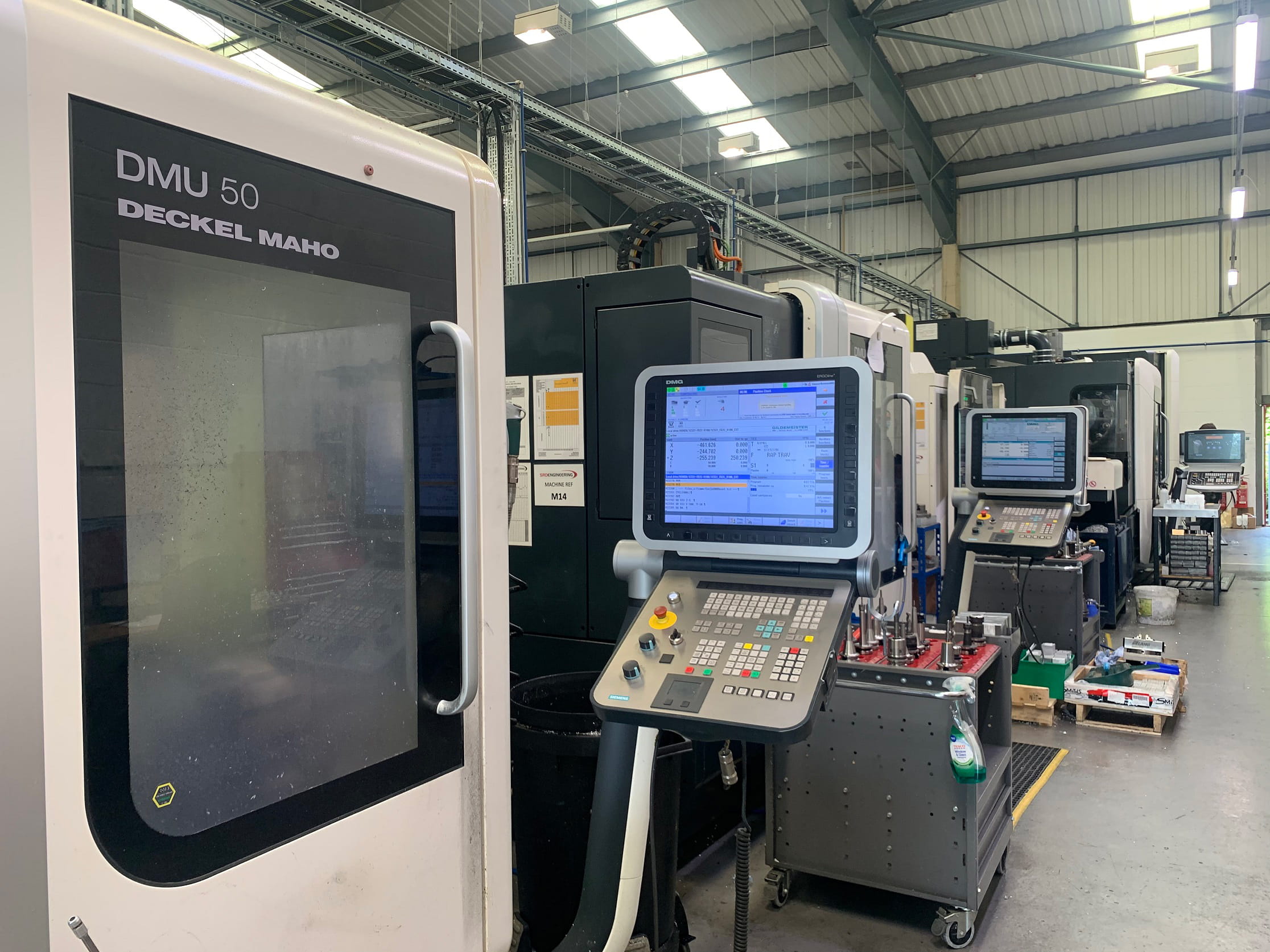

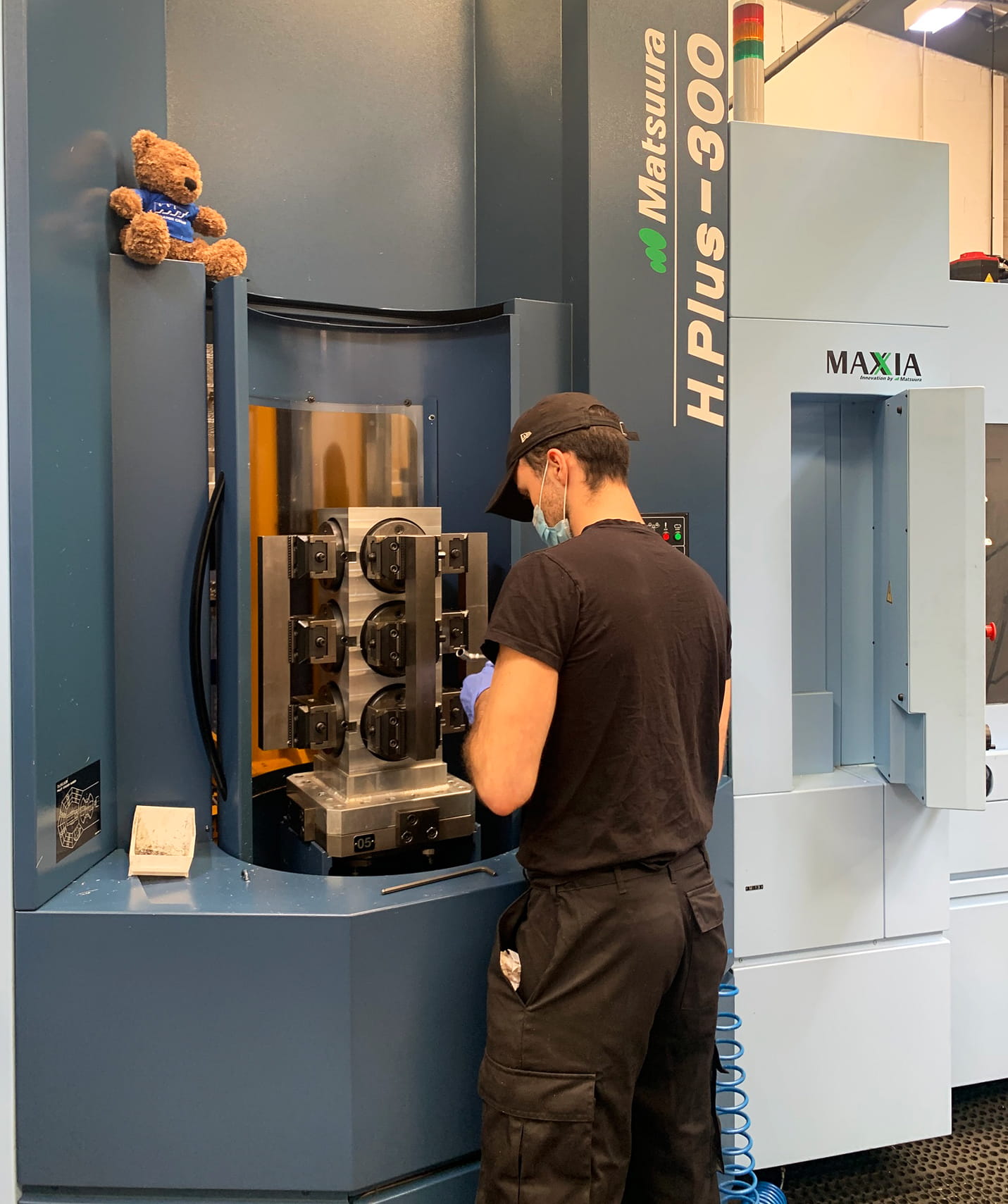

With regards to productivity gains from hyperMILL®, Chris continues: “Since we have been using hyperMILL®, we have definitely optimised our run cycles and there is a lot less ‘air cutting’. Additionally, some of our finishing cycles are a lot faster. We have one job that we were previously running at 45 minutes per part, and this is now down to 30 minutes. For this component, we produce around 60 parts a year and this gives us a saving of around 15 hours.” This 30% cycle time saving is magnified throughout the business, especially when considering that SRD has five 5-axis machines that includes DMG MORI machines and multi-pallet centres like the Matsuura HPlus-300.
The 80-employee business manufactures over 1,000 5-axis parts each month and the savings on these complex components has been impressive. “We have one motorsport part that was a batch of over 130 parts and the cycle time was over 3 hours per part. By re-programming this job with hyperMILL®, we have reduced the cycle time by 45 minutes per part, saving us over 100 hours of machining on just one job. We also have another component that we are producing at present for electrical testing machines, hyperMILL® has reduced the cycle time on this batch of 40 parts from 10 hours to 5 hours per part – a 50% cycle time reduction,” continues Chris.

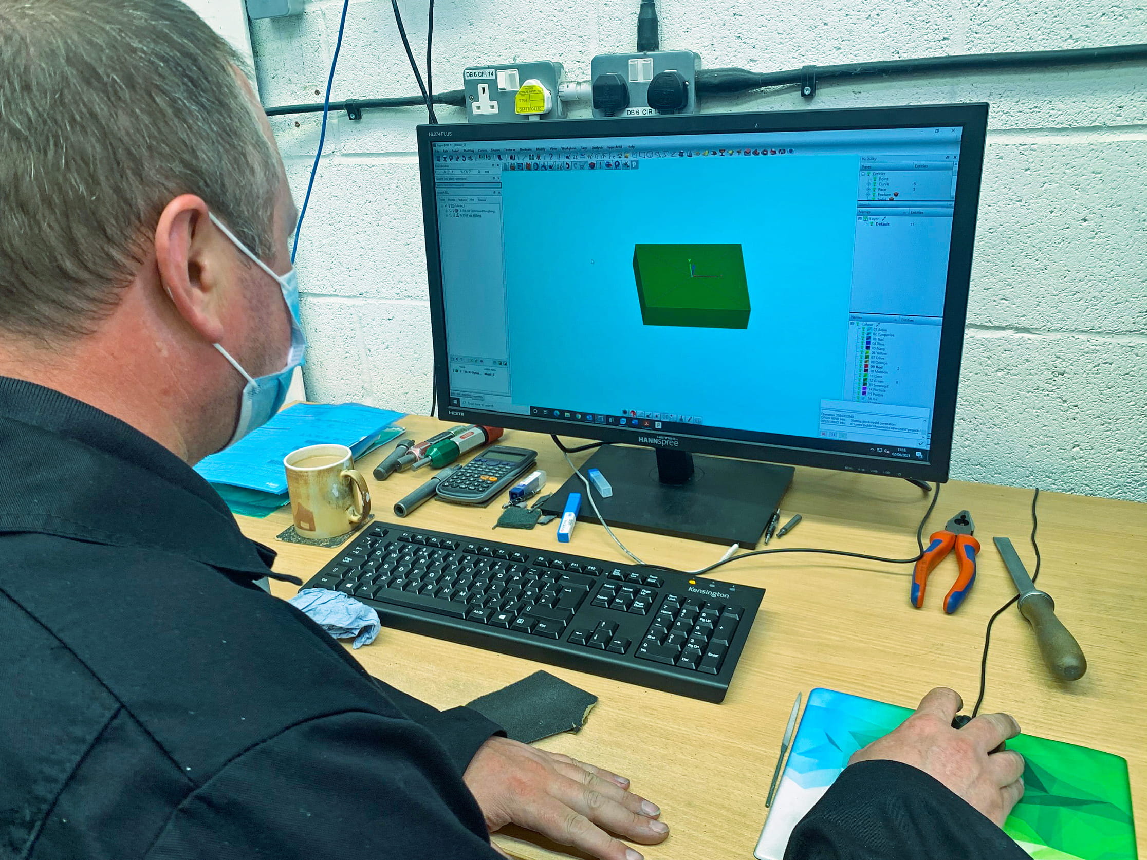

Since investing in OPEN MIND’s hyperMILL® CAM software last year, SRD Engineering has rapidly ramped up to nine seats of the industry-leading package with many of the shop floor machine operators programming their parts at the machine. “By programming at the machine, the operators take responsibility for following each job from the start to the end of the process. With often lengthy cycle times on complex parts, the operators can identify and eradicate any potential issues on the machine. With long-running parts, our team can also programme the next job whilst the machine is running. One feature in hyperMILL® that has saved us a lot of time is the pocket milling feature. It can machine straight and inclined pockets with any contour and with automatic recognition of islands and rest material areas. Open and closed pockets can also be machined easily when using the pocket milling strategy.”
