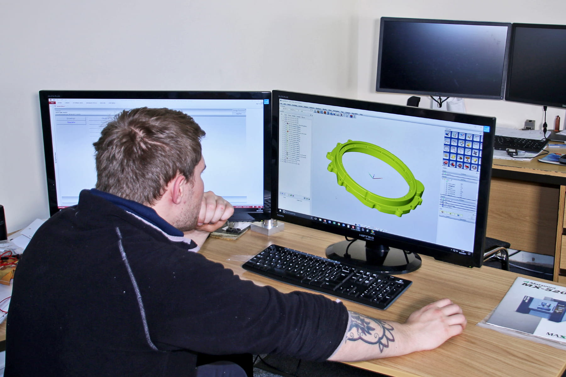

CNF bought its first hyperMILL® seat in October 2015 and a second seat followed just before Christmas, in time for the delivery of the new Matsuura MX520. Ramping up its programming capabilities, CNF now has two complete seats of hyperMILL® with three programmers. The productivity, capability and turnover at CNF have all grown considerably with its ongoing investment in new multi-pallet machine tools. Demonstrating the recent growth at the company and how hyperMILL® has contributed, Production Manager Mr Mark Baron says: “I used to spend 25 hours a week programming 2-4 complex jobs each week, using hyperMILL® I now spend a similar amount of time programming, but I get through up to 10 programs a week. As a department, we can program over 30 complex jobs a week. This would have been impossible without hyperMILL®. When we initially started with hyperMILL our programming times were instantly 20-30% faster, this is now more like 60% and as we continually become more proficient with the strategies, we'll get even faster programming times.”

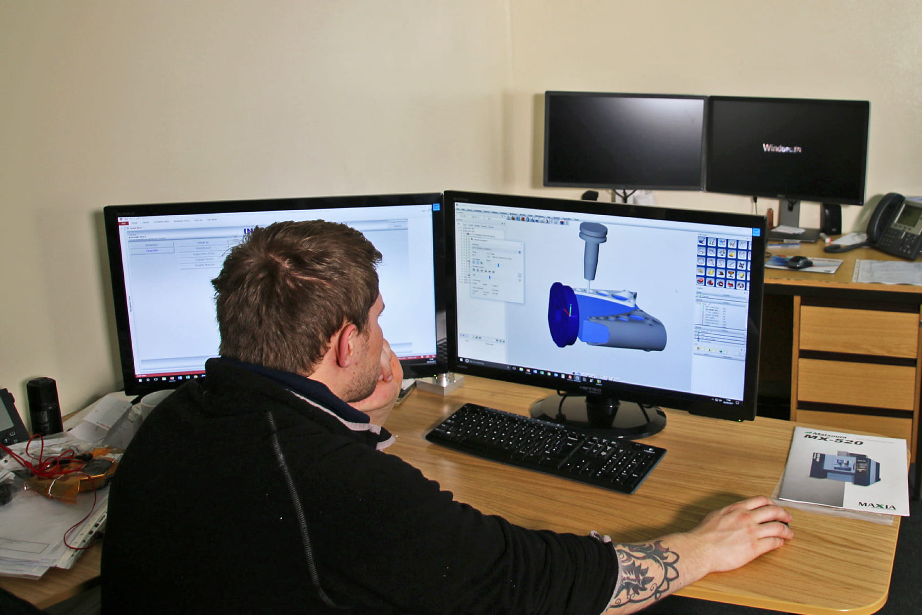

The improved programming times have been attributed to strategies such as 3D arbitrary stock roughing that has reduced programming times for roughing operations from 1-2 hours to less than 20 minutes in most instances. The ability to manipulate tool step-over with this cycle has also reduced machining times by 20-30%. Additionally, the 3D chamfer cycle recognises the shape of the part and contours the component with a chamfer tool with complete collision avoidance and this has also drastically reduced programming times when finishing parts.

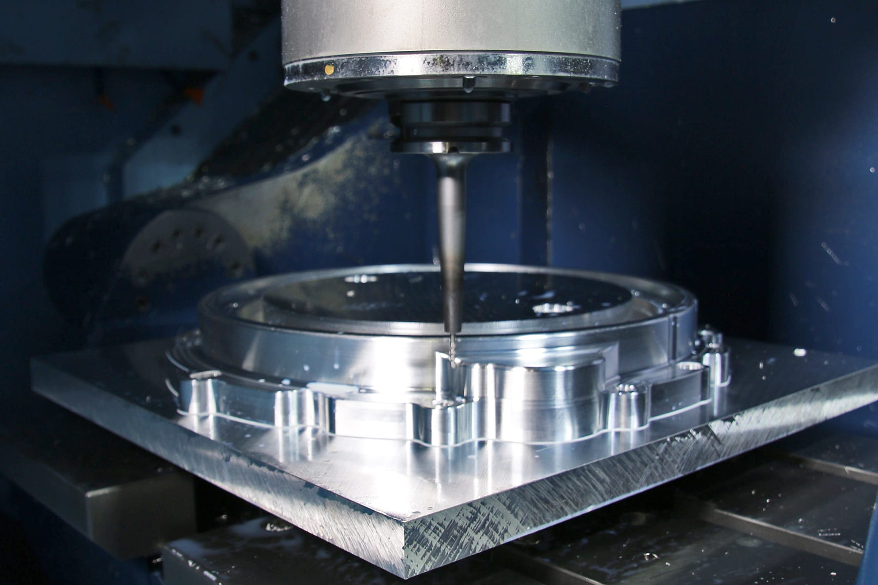

The roughing module of the hyperMILL® MAXX Machining performance package has been well publicised for its potential savings and CNF can certainly testify to the benefits. CNF has a throughput from 3500 to 6000 milled parts each month and over 50% of these components require rough machining. Its here that roughing strategies of hyperMILL® MAXX Machining are making a huge difference. As Mr Baron continues: “We used to use a lot of indexable cutting tools such as 20mm diameter end mills but the depth of cut and percentage step-over are both limited by the insert dimensions. We've applied the roughing strategy with solid carbide end mills and we can run the tool at a 20% step over rate with a full flute depth of cut that is often 50 to 80mm. The material removal rate is absolutely staggering. Added to this, we used to run our indexable tools at an 800mm/min feed rate, we are now running at 4 to 6m/min with solid carbide tools. That is up to seven times faster in many instances.” The result is that roughing cycles on steels and hard materials have been slashed by 80 to 90%, reducing overall cycle times and improving productivity by an average of 40-60% on many components. Despite the massive increase in material removal rates, CNF is witnessing huge tool life savings by moving to solid carbide tools and the innovative roughing strategies of the hyperMILL® MAXX Machining power package. Many of the solid carbide end mills from ITC are retained in the tool carousels of the multi-pallet Matsuura's for anything from 3 to 12 months. “Our tool life has increased by 100 to 140% since implementing solid carbide tools with 5-axis machining strategies. On the contrary to common thinking that harder and faster machining would increase the load on the machines, our spindle load has reduced significantly. We have moved from small depth of cut machining at 18,000rpm with indexable tools to 8000 to 10,000rpm spindle speeds with full depth machining. This has seen the spindle load fall by over 20% as we are running at the optimal torque levels.”
